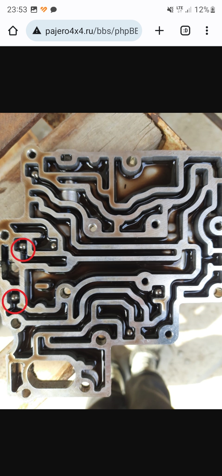

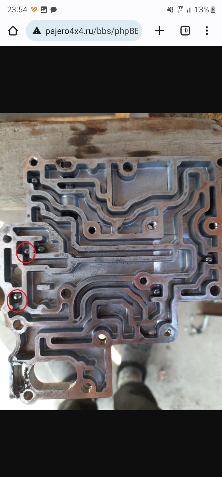

Всем привет. Подскажите пожалуйста правильное расположение 6 клапанов в гидроблоке. Нашёл страницы 3 назад 2 фото от одного человека, там по разному расположен 1 клапан. Все же, как правильно должно быть?

А на стальной пластине не видно? Там характерное отверстие для шарика должно быть. Сам я джуниоровский блок не разбирал, но суть та-же должна быть как и на многих других. Там это отверстие немного такое развальцованное что ли..

Если кому интересно, разобрался. Правильно как на 2 фото будет (где в масле все)

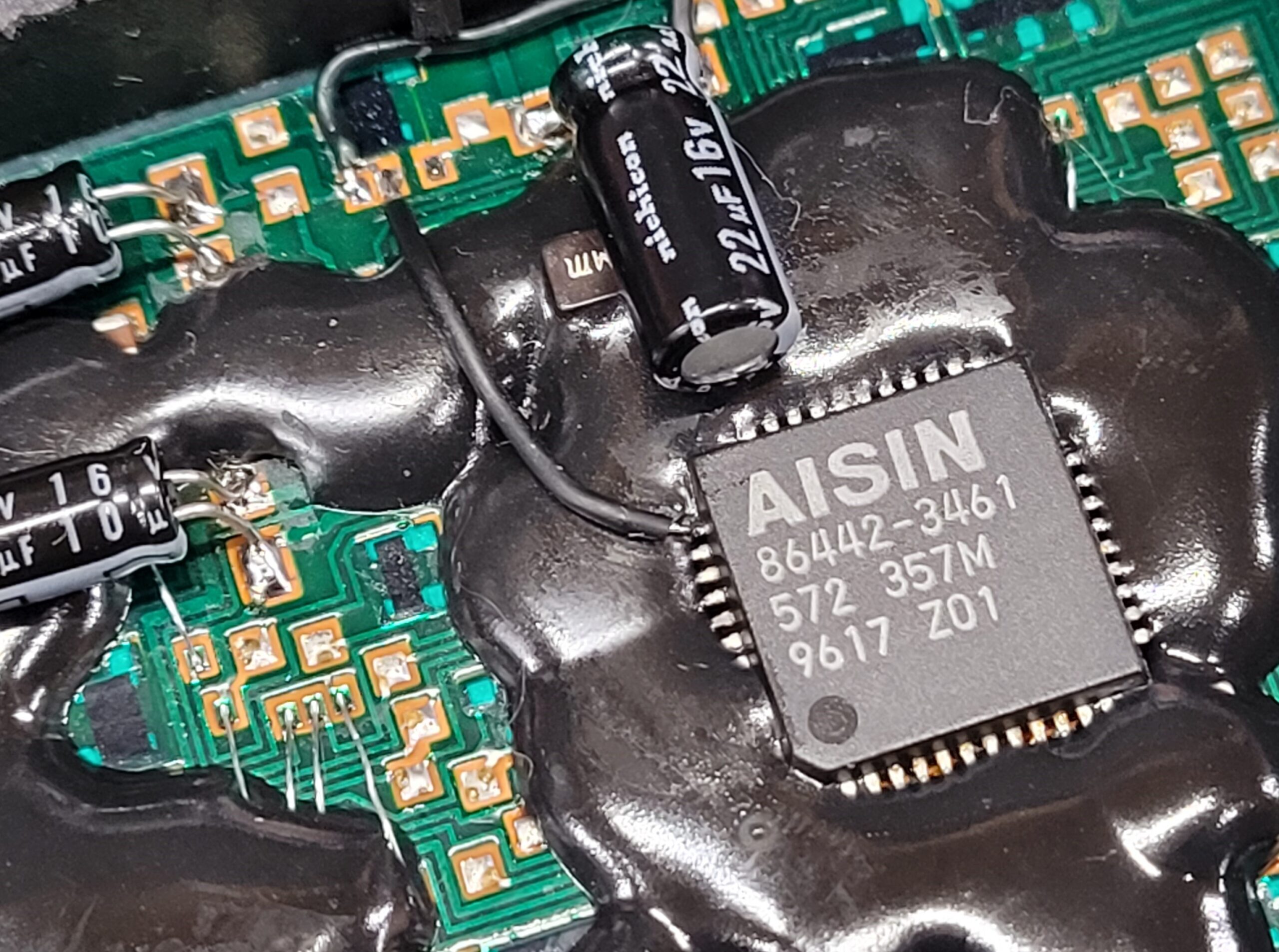

Hello, I have been fixing these Mits TCU's for a couple years now in the USA
#1 issue is the Electrolytic Caps 90% of the time.
#2 Issue is related to the caps the electrolytic acid destroys the conductive adhesive on the bonding wires they will look attached but they are not when the adhesive softens or corrodes away the connections break.
Most Common spot,
With the connector facing you there are 2 caps 22uf and 10uf at the top and 3 Small Bonding Wires that go in to the epoxy.
1st wire is Ground for half the board this can be connected to the GND Pad of the 22uf Cap.
2nd Bonding Wire: Connected to a pad that is connected to a Printed carbon resistor this one is buried deep in the epoxy but there is an alternate point on the MCU I believe pin 40 or 43? (Photo Attached! You can check continuity to the bit of wire left in the epoxy) sometimes this pin is in the clear other times its covered in epoxy but best place to attach with minimal epoxy removal.
3rd bonding wire: No Connection.
#3 is Corrosion and cracks at the printed carbon resistors making an open circuit. Nearly impossible to repair the printed resistors if they are covered in epoxy with out lots of grinding.
I plan to post all the Alternate points and measure all the Printed Carbon Resistors. Then use a surface grinder and slowly grind one down to expose whats under all the epoxy.

Dude! You're great! We change capacitors too, but no one has dug that deep yet.

I plan to make a repro pcb for the ones that are beyond repair, Just swap the MCU to a new PCB.

It would be a good idea. If possible, post your developments here. We would be very grateful.
