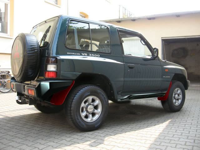

Hello mitsubishi comrades!
I'm building a metal bumper for my paj right now. I'm designing it in AutoCad and when this stage is finished, the drawings will be sent to a friend of mine for production. I'm trying to be as accurate as I can, so I'm gonna need the blueprins of this specific model... anyone knows where I can find them?
This is a previous concept design of the bumpers on a stock pajero...

Not bad. :) I sow post with drawings of P2 metal bampers here.
Here is link to gallery with some drawings - http://www.pajero4x4.ru/fgallery/thumbn ... ?album=757
PS: Nice P2 restyle. :)

Сообщение Troll »
Nice and clean design!.... although it's for 92-97 models.
1998-99 models are wider due to their expanded fenders... that's why I'm looking for blueprints from the specific model. :wink:

On your photo i see only corners of bampers raplaced by metal parts. I think it's lowcost solution, and you don't need to replace central parts of current bumpers, cause they already metal. :)
BTW, why not to install BFG AT or MT at 31x10.5 R15 size? Theese tyres more agressive then yours atm.

Thank you for replying guys!
At the beginning I thought that it would be better to replace the current plastic corners. The whole structure would not be so durable or strong though. So I've decided to replace the whole bumper.
PS. Previous pictures were used for illustrative purposes. I had not a single clean shot from my rig, but here it is. Runs on 265/75r16 Cooper STTs.
The nudge bar is gone though....

No.... it's not drafts of a bull bar I'm looking for.... I need the blueprints of a Pajero NL in order to make my own bullbar... something like this but for a Pajero NL
