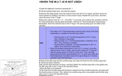

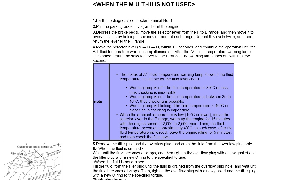

markovin писал(а):Вот что нашел -как проверить уровень масла в акпп без щупа :<When the M.U.T.-III is not used>
1.Earth the diagnosis connector terminal No. 1.
2.Pull the parking brake lever, and start the engine.
3.Depress the brake pedal, move the selector lever from the P to D range, and then move it to every position by holding 2 seconds or more at each range. Repeat this cycle twice, and then return the lever to the P range.
4.Move the selector lever (P → D → P) within 1.5 seconds, and continue the operation until the A/T fluid temperature warning lamp illuminates. After the A/T fluid temperature warning lamp illuminated, return the selector lever to the P range. The warning lamp goes out within a few seconds.
NOTE:
The status of A/T fluid temperature warning lamp shows if the fluid temperature is suitable for the fluid level check.•
Warning lamp is off: The fluid temperature is 38•°C or less, thus checking is impossible.
Warning lamp is on: The fluid temperature is between 38 to 46•°C, thus checking is possible.
Warning lamp is blinking: The fluid temper•ature is 46°C or higher, thus checking is impossible.
When the ambient temperature is low (10°C or lower), move the selector lever to the P range, warm up the engine for 15 minutes with the engine speed of 2,000 to 2,500 r/min. Then, the fluid temperature becomes approximately 40•°C. In such case, after the fluid temperature increased, leave the engine idling for 5 minutes,
5.Remove the filler plug and the overflow plug, and drain the fluid from the overflow plug hole.
6.<When the fluid is drained>
Wait until the fluid becomes oil drops, and then tighten the overflow plug and the filler plug to the specified torque.
<When the fluid is not drained>
Fill the fluid from the filler plug until the fluid is drained from the overflow plug hole, and wait until the fluid becomes oil drops. Then, tighten the overflow plug and the filler plug to the specified torque.
Tightening torque:
20 ± 2 N⋅m (overflow plug)
39 ± 15 N⋅m (Filler plug)
Вот перевод гугла:
1.Earth терминал диагностическому разъему № 1.
2.Pull рычаг стояночного тормоза и запустите двигатель.
3.Depress на педаль тормоза, переместить рычаг селектора из P в диапазоне D, а затем переместить его в любом положении, удерживая 2 секунды или более в каждом диапазоне. Повторите этот цикл в два раза, а затем вернуть рычаг в диапазоне P.
4.Move рычага селектора (P → D → P) в течение 1,5 секунд, и продолжать операцию до A / T температура жидкости контрольная лампа загорается. После того, как A / T температура жидкости контрольная лампа горит, вернуть рычаг селектора в диапазоне P.Контрольная лампа гаснет через несколько секунд.
ПРИМЕЧАНИЕ:
Состояние A / T жидкость лампа температуры показывает, если температура жидкости подходит для проверки уровня жидкости. •
Сигнальная лампа не горит: температура жидкости 38 • ° C или меньше, таким образом, проверка невозможна.
Сигнальная лампа горит: температура жидкости составляет от 38 до 46 • ° C, таким образом, проверив это возможно.
Сигнальная лампа мигает: жидкость нрав • ратура составляет 46 ° C или выше, таким образом, проверка невозможна.
При низкой температуре окружающей среды (10 ° C или ниже), переместить рычаг селектора в диапазоне P, прогреть двигатель в течение 15 минут с частотой вращения двигателя от 2000 до 2500 об / мин. Тогда, температура жидкости становится примерно 40 • ° C. В таком случае, после того, как температура жидкости увеличен, оставьте двигатель на холостом ходу в течение 5 минут,
5.Remove заглушку и переполнения вилку, и слейте жидкость из отверстия плагин переполнение.
6. <When Жидкости drained>
Подождите, пока жидкость не станет капли масла, а затем закрутить пробку переполнения и заливную пробку на указанный момент.
<When Жидкость не drained>
Заполните жидкости из заливного отверстия, пока жидкость сливается из заглушка перелива, и ждать, пока жидкость не станет капли масла. Затем закрутить пробку переполнения и заливную пробку до указанного момента.
Момент затяжки:
20 ± 2 Н ⋅ м (переполнение вилкой)
39 ± 15 Н ⋅ м (Filler вилкой)
Вот цитата с форума прадоводов, (у нас их коробка?!):
АКПП 5 ст переводится в режим контроля температуры так: замкнуть проводком 4 и 13 контакт диагностической колодки слева под рулем. (счет слева направо, в верхнем ряду 1-8, в нижнем 9-16 контакты)
Запустить двигатель.
Медленно перевести рычаг КПП из Р в L и обратно в P.
Быстро перевести рычаг КПП из D в N и обратно 6 раз.
На 2 секунды загорится лампа OIL TEMP на приборке и погаснет. Все норм, убираем проводок и ждем пока масло прогреется на холостых до рабочей температуры. Лампа не горит - масло холодное. Лампа горит - температура нормальная, лезем проверять уровень масла по машину на заведенной. Если лампа мигает - масло перегрето. Под машиной (на работающей) откручиваем контрольную пробку (шестигранник на 5) если масло не льется из нее - доливаем через заливную (заливная справа по ходу авто в районе соединения с раздаткой, под ключ на 24) пока из контрольной не польется, как литься перестает, начинает капать - закручиваем контрольную и заливную и радуемся. После выключения двигателя коробка встает сама в обычный режим.
Вопрос: Кто-нибудь так делал?
И разъяснения SNOOPER без перевода Гуглом тоже были.

Наконец дошли и у меня руки до замены жидкости в нашей АКПП.
Менял жидкость на TOYOTA ATF WS методом слил - залил - поездил - слил - залил.
Перед заменой конечно изучил мануалы, но все равно возникли вопросы.
По порядку:
Первый вопрос возник при измерении температуры жидкости, вроде все сделал как по мануалу, но индикатор температуры зажечь так и не получилось!
Может конечно был плохой контакт между первым выводом и землей(вывод 4) на диагностическом разъеме!? Если у кого то получилось, подскажете нумерация
выводов на диагностическом разъеме начинается от водителя или от моторного отсека?
Так как интернета под рукой не было, то измерять температуру жидкости пришлось сподручными средствами:) Под рукой оказался обычный ртутный градусник,
по размерам он как раз вошел в заливное отверстие АКПП, при первом замере оказалась температура была больше 42 градусов, подождал
когда коробка остынет и при температуре примерно 40-41 градус решил проводить контроль уровня.
Второй вопрос "Правильно ли я проверял уровень?" Проверял на заведенном двигателе и АКПП в положении "Р", открутил контрольную пробку
с нее с начало по капало потом потекло тоненькой струйкой толщиной со спичку, потом опять по капало и снова полилось тоненькой струйкой
и так повторялось много раз, дожидаться пока перестанет вообще капать я не стал, так как посчитал что чем дольше я жду тем больше прогревается коробка и соответственно увеличивается объем жидкости, в итого я слил примерно 150-200 граммов. У всех так было или у меня только?
Может что сделал не правильно, как думаете?
