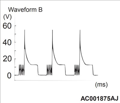

Значит все таки ШИМ.The Lock-up was first developed by us about 15 years ago and was a 12 volt input and used mainly on 80 series Toyotas and GQ patrols.
Later on we added the resistor for later models with more sophisticated electronics as suggested.
In the last 2 years we now have developed a control module that recognises the transmission type by the solenoid resistance and mimics the exact PWM signal that is operated by the factory software,
this insures no damage to the solenoid is possible even if the switch is overused and /or used outside our recommended parameters.
The will be no issues if the unit is used as suggested in the instructions.

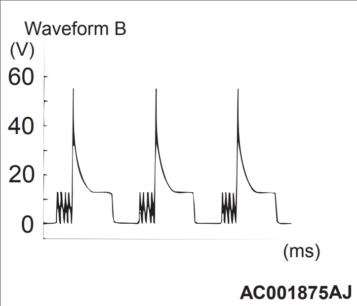

Спасибо! ШИМ какой-то странный, он идет перед всплеском на 60 Вольт, а не после него, что было бы логичнее при удержании. Но японцам виднее.SNOOPER писал(а): Значит все таки ШИМ.
