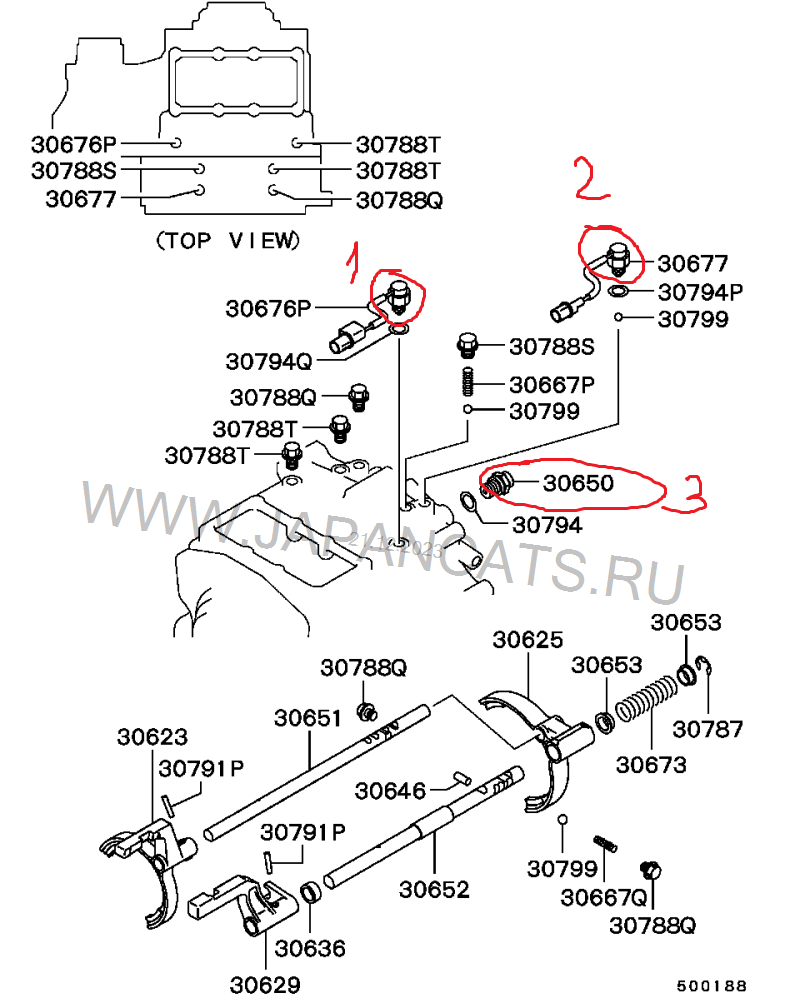

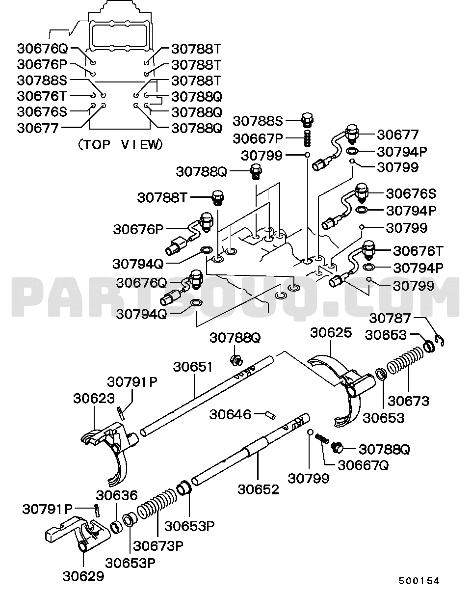

Hello good people.
I will reopen the thread for details if anyone can share. I'm from Bulgaria and no one here has done such a transfer from Easy Select to Super Select :)

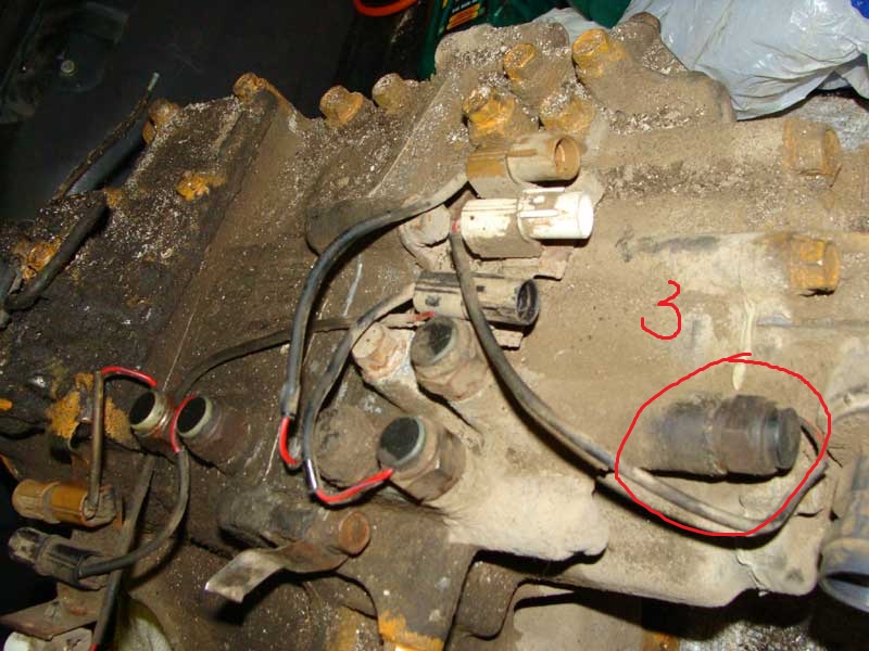

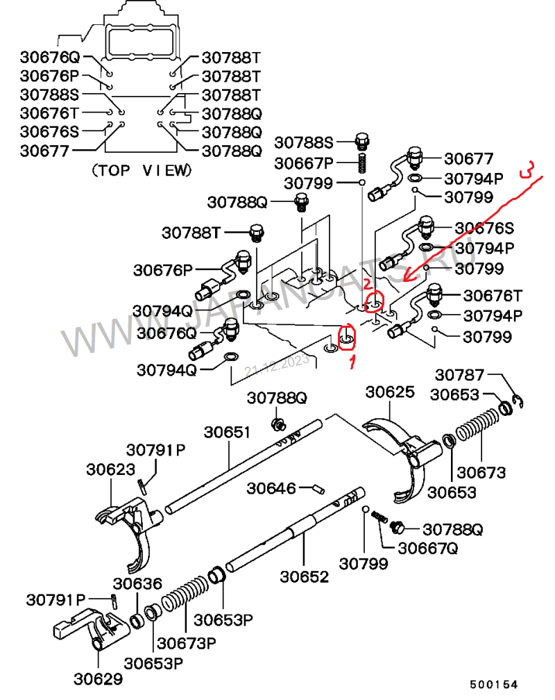

I have a Pajero sport 3.0 A/T and a Super Select 3.5 transfer case in my garage. The question I couldn't find in the entire thread is the sensor connection. Sport has 3 sensors and Super Select has 5 sensors. How should I transfer and wire my 3 sensors to work properly and the Super Select to work properly. If anyone has pictures of their box or a schematic I would appreciate it if you could share.

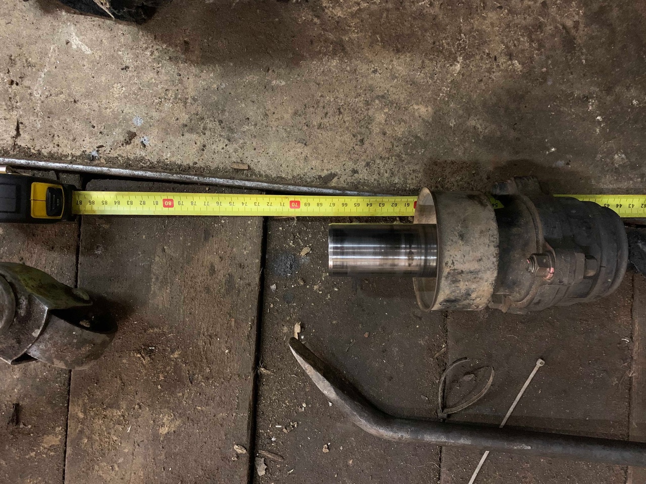

Also, as far as I understand the propshaft, those dimensions should be center to center front 65mm and rear 920mm?
If anyone has accurate information i can also give email and whatsapp.
Thanks!

1-
2-1
3-
4-
5-2
6-3
RDimitrow
Сообщения: 4
Зарегистрирован: 21 дек 2023, 15:37
Откуда: Sofia
Super Select для Спортов
Сообщение RDimitrow »
and what is the numbering? where does 1 start and where is 6
Cruelll
Сообщения: 313
Зарегистрирован: 12 июл 2012, 14:26
Откуда: Екатеринбург
Поблагодарили: 28 раз
Сообщение Cruelll »

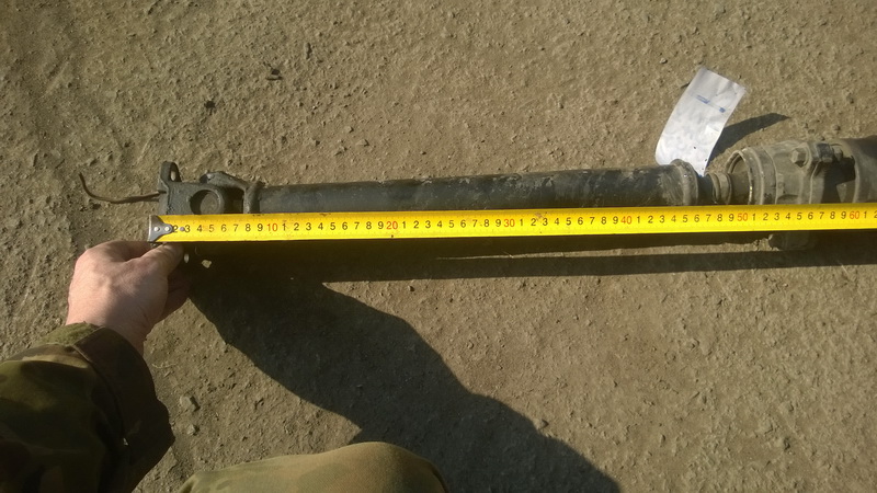

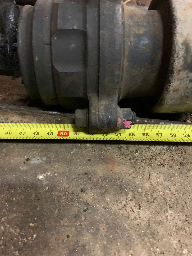

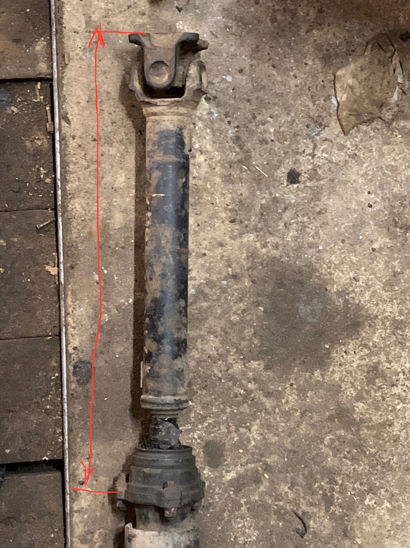

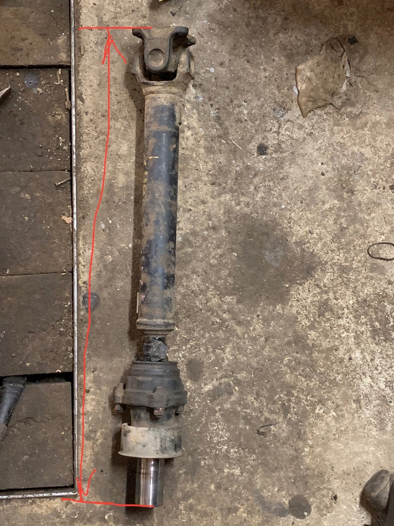

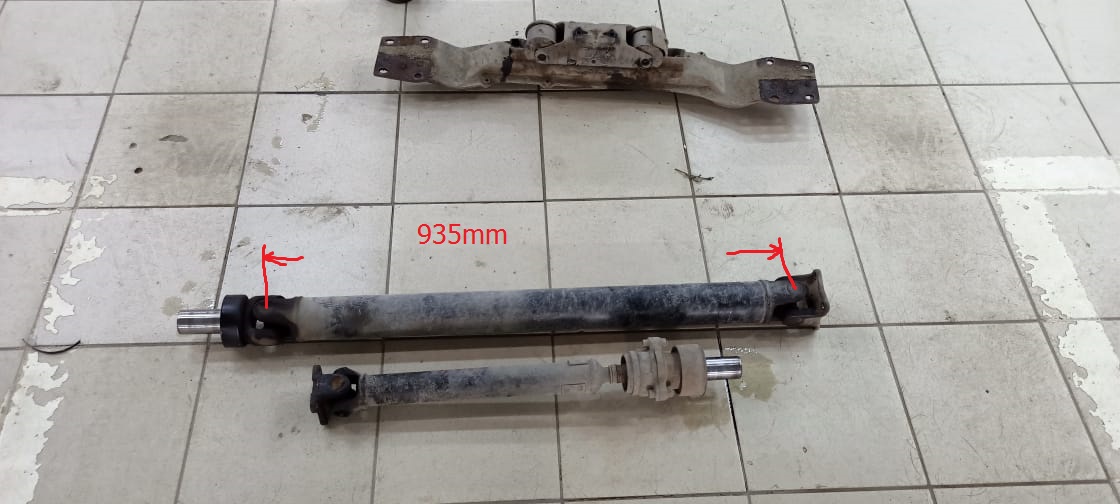

wonderful. Thank you very much. no accurate drive shaft info? Or is it just cutting into my propeller shafts? I have a 2.8 Challenger but they are not the same
Cruelll
Сообщения: 313
Сообщение Cruelll »
Super Select for k96 mps 3.0 a/t
front
56cm

Cruelll
Сообщения: 313
Сообщение Cruelll »

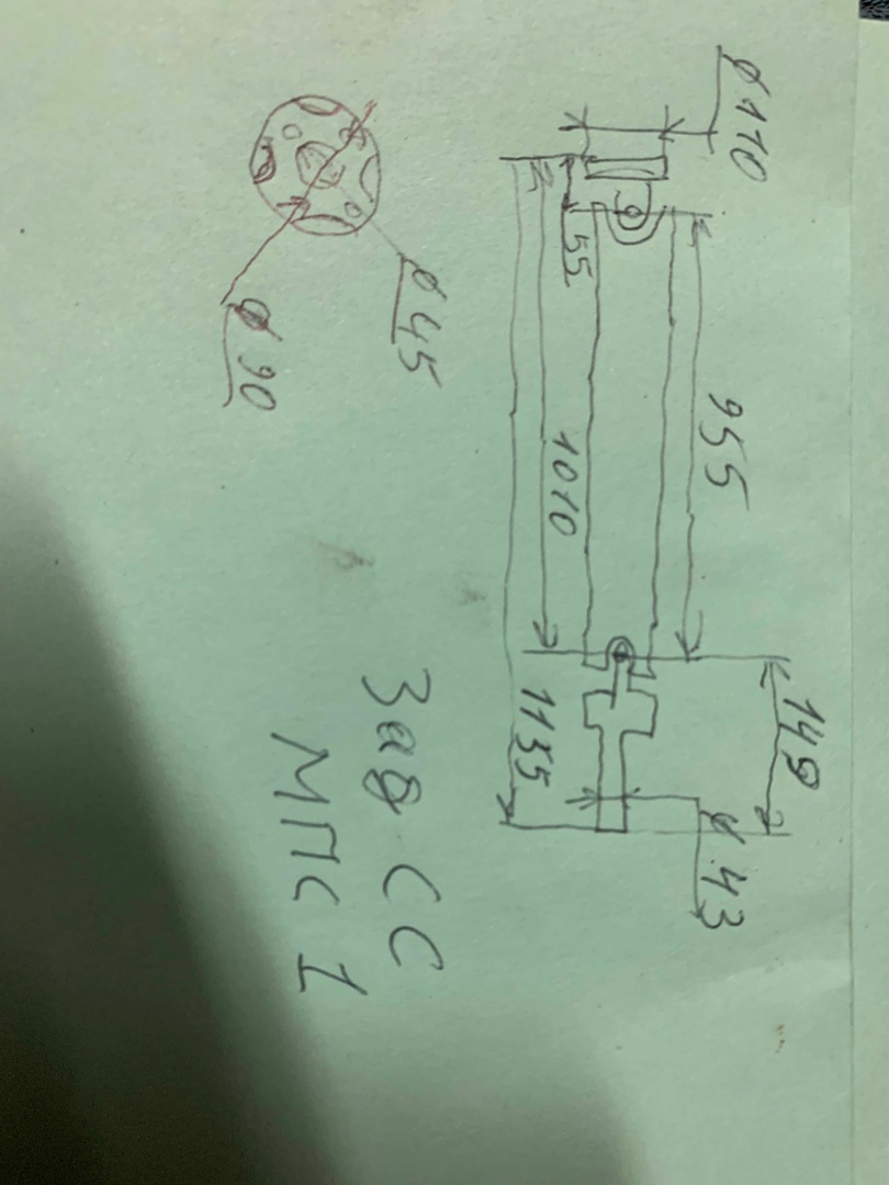

rear

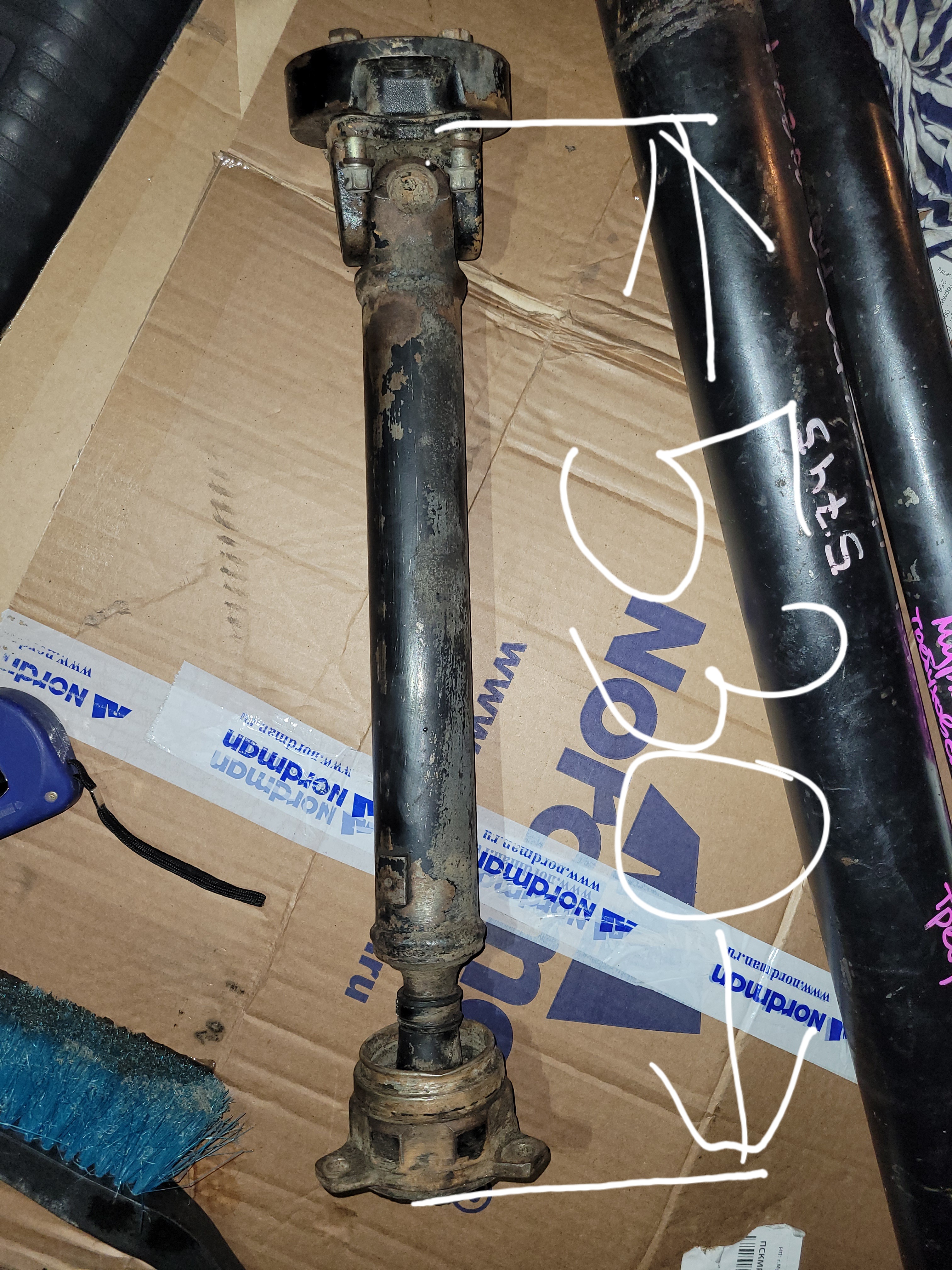

Серго22 писал(а): а передний от края до края 530
Всем доброго времени суток! Подскажите пожалуйста, от каких краёв именно считать эти 530мм.
Начальная точка отсчёта это шрус или проставка? А конечная?) Вообщем запутался я. Правильно я отрисовал или всё таки нет?)
