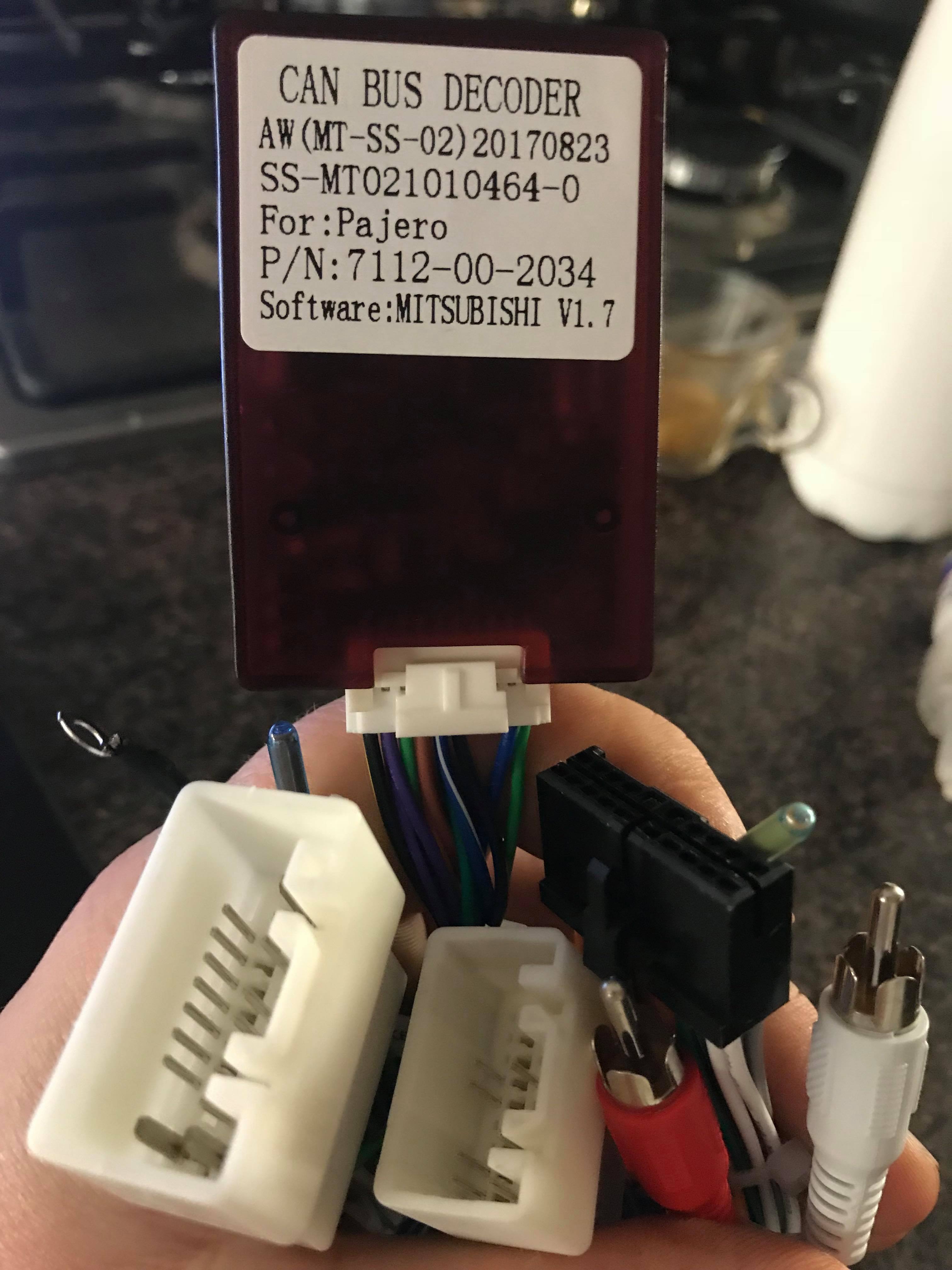

Re: ГУ (Головное Устройство) на Android для Pajero IV
Hi Pajero friends in Russia!
I'm trying to read this forum with google translate (witch is near hopeless).
It seems as the bast information about Android head units in Pajero comes from Russia. I've been searching all over the www to find good information about the topic!
The thing is that a was ordering this Andorid unit to my 06 Pajero gen4 with the Rockford unit without screen.
https://www.aliexpress.com/item/2-Din-7 ... 0.0.oxav1q
(with the canbus unit)
The only problem is that before it had arrived with mail I had sold the car, and bought a 08 Pajero gen4 with the Rockford unit WITH screen and with the "grey" connectors and rockford amplifier.
The unit I have don't support this.
I see that some of you have tested the "Axxess Interface MITO-02", do you think that I could this to work with this adapter?
Any other suggestions?
I hope that some of you can help me out, preferably in English, if not write in Russian and I use google translate
Best wishes
Nicholas from Norway
The task of the adapter to align the signals, not the head unit with standard sound system Rockford Fosqate. But past that, my adapter has four inputs for the acoustic signal, so the output we get all four speakers working (unlike other adapters, after which rear speakers do not work). All four speakers as it should normally not adjustable from the head unit (front, back, left, right). Also on the adapter there are controllers that you can use to correct the signals incoming from the radio (mid\high and subwoofer control).
The connection adapter is not any difficulty. On the one hand there are female terminals that connect to the wiring of Mitsubishi and line inputs of type "Tulip" which are connected to outputs of the radio. Also, there are additional interface wires to connect extra equipment (rear camera, speed sensor, etc.). The most important is not forgotten to connect the blue wire from the adapter to the blue wire on the output of the radio. With this question
vit.tr
- Сообщения: 113
- Зарегистрирован: 03 фев 2015, 19:59
- Двигатель:: дизель
- Мой автомобиль(и):: Паждеро IV
- Откуда: Северная Столица
- Поблагодарили: 3 раза
There are different implementation of this device, but judging by the forums works best Axxis MITO-02.
IMPORTANT: This adapter is NOT FOR the PAJERO, it is designed for Lancer and out, which can tire a little different than the Pajero. BUT the principle of management of Rockford that have the same Pajero, Lancer. Therefore, this adapter WORKS with the PAJERO.
Due to the fact that the adapter is "not our", functions the can-bus won't work — namely, adapter APHIS on the Pajero you can't remove the reversing signals, the speed signal and Parking brake signal, as it does not extinguish the error in the audio on the border in the Pajero. All these signals need to take the wiring from the car. Accordingly on the adapter do not connect them anywhere.
For connection of the axis — it works out of the box, except for the fact that the EARTH must be connected to the BODY (there is a special bolt on the bottom bracket of fastening of radio, visible in the photo, the bolt right next to the antenna wire) this is important (in the connector block on the ground combined with the speed sensor signal, so there may be side effects when the machine will not be able to understand correctly the current speed). It cost me one night of stupid, why is not working.
The second point — when you first enable system amplifier I somehow didn't take, it's cost me a stupid 10 minutes. But when you turn the ignition all got started — I suspect it's in the radio, which when you first turn not startovala amplifier.
its from https://www.drive2.ru/search/?searchid= ... ss+mito-02
Thanks for the feedback!
I've just came across this adapter that I know has been used on a 08 Pajero with big Rockford package (big screen + amplifier) that has the grey connectors.
http://www.world-beatsonic.com/audio_ad ... er-dsa-05/
To get the reversingcamera to work you need this:
http://www.world-beatsonic.com/cameras_ ... ries/bc19/
And to get the steeringwheelbuttons to work you need this:
https://axxessinterfaces.com/product/ASWC-1
This has been tested with a Pioneer head unit.
The only problem here is the price, it's realy expencive.
Strange that no Chineese compay has reversedengineered this.
