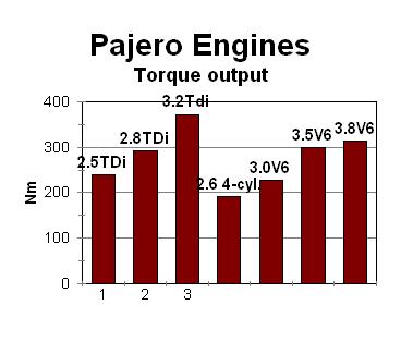

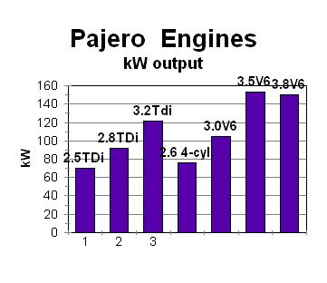

Alex_F
4G54
Used in Gen1 & (some) Gen2 Pajeros
4cyl petrol
2600cc
Output: 76/79kW
Torque: 192Nm
6G72
Used in Gen1 & Gen2 Pajero
Used in L200 / Colt / Triton
V6 SOHC petrol
3000cc
Output: 105/109kW
Torque: 228/234Nm
6G74 (3.5 DOHC)
Used in Gen2 Pajero
V6 DOHC petrol
3500cc
Output: 153kW
Torque: 300Nm
6G74 (3.5 SOHC)
Used in Gen2 Pajero
V6 SOHC petrol
3500cc
Output: 140kW
Torque: 303Nm
6G75 (3.8 SOHC)
Used in Gen3 Pajero
V6 SOHC petrol
3800cc
Output: 150kW
Torque: 314Nm
4D56T
Used in First local Colt bakkies
Used in latest Triton bakkies (common rail)
4cyl diesel
Turbo, some models intercooled, latest version is common rail
Output: 62/70kW
Torque: 201Nm
4M40 NA
Used in some local Colt bakkies
4cyl diesel NA
Output: 71kW
Torque: 198Nm
4M40 TDi
Used in Gen2 Pajero
Used in local Colt bakkies
4cyl diesel
Turbo, intercooled
Output: 92kW
Torque: 292Nm
4M41 Di-D
Used in Gen3 & Gen4 Pajero
4cyl diesel
Turbo, intercooled, direct injection
Output: 121kW
Torque: 373Nm
http://www.4x4community.co.za/forum/sho ... hp?t=15197

kyzya11
Alex_F писал(а):6G72
Torque: 228/234Nm
6G74 (3.5 DOHC)
Torque: 300Nm
6G74 (3.5 SOHC)
Torque: 303Nm
6G75 (3.8 SOHC)
Torque: 314Nm
:shock:
что то странные значения если я правильно понял что это мах значений
