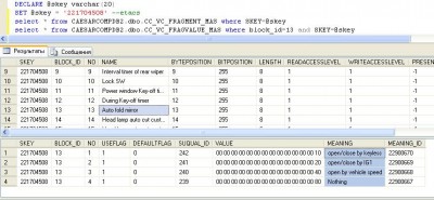

копался в кодинге и зашел в тупик.
Машина спорт 2010 s05
select * from CAESARCOMPDB2.dbo.TYPE_MAS where TYPE='KH4W' --265
select * from CAESARCOMPDB2.dbo.KIND_MAS where KIND='GYPZL6Z' --1915
select * from CAESARCOMPDB2.dbo.MODELYEAR_MAS where MODELYEAR='2010' --10
select * from CAESARCOMPDB2.dbo.VEHICLE_EXT where MODELYEAR_ID=10 and TYPE_ID=265 and KIND_ID=1915 --1106060011
--select * from CAESARCOMPDB2.dbo.VKEY_LANG_EXT where BLOCK_ID=1106060011 --60
--select * from CAESARCOMPDB2.dbo.VEHICLE_LANG_MAS where ID=60
select * from CAESARCOMPDB2.dbo.FLASHCLASS_EXT where BLOCK_ID=1106060011
--1 Двигатель
select * from CAESARCOMPDB2.dbo.CAESAR_CLASS_PRO where MUTCLASS=360001--360001
select * from CAESARCOMPDB2.dbo.SKEY_EXT where ID=360001 ORDER by SKEY
--2 Иммобилайзер
select * from CAESARCOMPDB2.dbo.CAESAR_CLASS_PRO where MUTCLASS=520001--520001
select * from CAESARCOMPDB2.dbo.SKEY_EXT where ID=520001 ORDER by SKEY
--3 АКПП
select * from CAESARCOMPDB2.dbo.CAESAR_CLASS_PRO where MUTCLASS=260001--260001
select * from CAESARCOMPDB2.dbo.SKEY_EXT where ID=260001 ORDER by SKEY
--4 abs
select * from CAESARCOMPDB2.dbo.CAESAR_CLASS_PRO where MUTCLASS=70001--70001
select * from CAESARCOMPDB2.dbo.SKEY_EXT where ID=70001 ORDER by SKEY
--5 ASTC
select * from CAESARCOMPDB2.dbo.CAESAR_CLASS_PRO where MUTCLASS=220001--220001
select * from CAESARCOMPDB2.dbo.SKEY_EXT where ID=220001 ORDER by SKEY
--6 Климат-контроль
select * from CAESARCOMPDB2.dbo.CAESAR_CLASS_PRO where MUTCLASS=130001--130001
select * from CAESARCOMPDB2.dbo.SKEY_EXT where ID=130001 ORDER by SKEY
--7 ETACS
select * from CAESARCOMPDB2.dbo.CAESAR_CLASS_PRO where MUTCLASS=450002--450002
select * from CAESARCOMPDB2.dbo.SKEY_EXT where ID=450002 ORDER by SKEY
--8 SAS
select * from CAESARCOMPDB2.dbo.CAESAR_CLASS_PRO where MUTCLASS=660001--660001
select * from CAESARCOMPDB2.dbo.SKEY_EXT where ID=660001 ORDER by SKEY
В етаксе есть SKEY, который подходит под нашу машину по функциям - это либо 7-ой, либо 8-ой.
DECLARE @skey varchar(20)
--SET @skey = '10003610' --двигатель
SET @skey = '221704507' --etacs
--select * from CAESARCOMPDB2.dbo.CC_DOMAIN_PRO where SKEY=@skey
--select * from CAESARCOMPDB2.dbo.CC_VC_ITEM_REF where SKEY=@skey and block_id=4900003
select * from CAESARCOMPDB2.dbo.CC_VC_FRAGMENT_MAS where SKEY=@skey
select * from CAESARCOMPDB2.dbo.CC_VC_FRAGVALUE_MAS where block_id=19 and SKEY=@skey
Вот эти функции

Интересны те, которые выделены жирным шрифтом
18) закрытие дверей при 20 км/ч
19) открытие дверей при "P"
28) Штатная сигнализация.
Кто-нибудь сливал кодинг Etacs-а МУТ-ом и правил?
Двигателя кодинга в базе вообще нет, т.е. либо он вообще не сливается, т.е. он не предусмотрен заводом, либо просто нет информации в базе МУТ-а.
Кто знает может есть кодинги "глючной" коробки и "глючного" климата?
Вообщем пока встал из-за отсутствия МУТ3, поеду на очередное ТО к ОД, если не пошлют - то посмотрю на экране подробнее...
Либо старье нам ставят на заводе в угоду удешевления, либо у етакса не очень навороченный процессор, либо просто не докопался.
Возможно вообще у нас нет никаких кодингов кроме Etasc-а...
Везет аутам - там можно много чего наконфигурировать, не трогая заводскую прошивку...

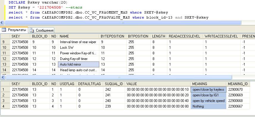

Я когда брал Спорта сразу же заехал к диагностам поковыряться в кодинге. Поскольку раньше таким образом настраивал Аут ХЛ, мастер отнесся с пониманием и ему самому интересено было. В МУТе можно кстати выбрать язык и посмотреть все по-русски.
К сожалению у Спорта очень маленький список того, что можно изменить и официально можно лазить только в ЕКТАКС.
Вот у меня есть список на английском, это то что будет видно МУТом (русского перевода к сожалению нет, но можно кое-что понять). К слову сказать Аутовский список был раза в три длиннее.
Из того что выделено и хотелось бы:
- закрытия дверей точно нет (не позволяет блок ЦЗ, нужно делать отдельную схемку с реле, это можно сделать на Лансерах и Аутах ХЛ с другой системой ЦЗ, которая к нам не поставляется). Тоже хотел, но...;
- открытие дверей при постановке в "Р" возможно. Если сигналка закрывает двери при начале движения (например у меня), то возможно и будет удобной опцией, т.к. открывает она их только по выключению двигателя (я не стал себе это активировать из соображений безопасности, на Ауте было). Поскольку невозможно первое, нужно ли это...;
- штатная сигналка из той же оперы про ЦЗ, нужна другая система. На Аутовском форуме эту тему очень долго обсуждали, в общем требуется во-первых система с бесконтактным доступом, но к ней еще куча чего, что шло только на штатовский рынок (там кстати можно было дополнительно активировать заводской автозапуск!). На нашу машину поставить невозможно в принципе, потому как изначально проще все электрика сделана.
В общем изучение форумов и общение со специалистами привели меня к выводу, что Паджеро Спорт, L200 и Паджеро 4 сделаны по упрощенной схеме. По этой причине невозможно что-то настраивать в машине, невозможно поставить полноценную MMCS (через нее кстати некоторые функции можно самостоятельно настраивать, что я например и сделал на ASX супруги). Платформа, на которой построены АУТ ХЛ, Лансер и ASX более продвинута в этом плане и по некоторым возможностям приближена к современным платформам европейских производителей (у некоторым марок, например БМВ, можно много чего настраивать под себя и есть возможность приобретать дополнительные опции с их активацией, но это заложено в машине изначально). Однако к нам в Россию поставляют обрезанные комплектации и этих моделей, и даже имея МУТ не все можно настроить из-за отсутствия необходимых модулей в самой электросхеме машины. Мастер у ОД говорил, что например на АУТах 2007-2009 годов можно было много чего настроить через МУТ, а вот на машинах с 2010 года некоторые опции уже были запрещены на программном уровне, а с 2011 года не просто запрещены, но и удалены физически. Что это, жадность дилера, или глобальная экономия производителя, раз эти опции не заказываются?
Вот как-то так.
Вот как-то так.

SKS, спасибо за отклик. Дело в том, что все эти 28 функций Etacsa, которые я привел возможно самому поменять, даже если ОД не может это сделать своим МУТ-ом, например поле недоступно для изменения.
Делается это так. В Муте выбиратеся etacs-coding-codinginformatio©-save на жесткий диск.
На выходе получаем текстовый файл кодинга. Правим по определенному алгоритму желаемую опцию, пересчитываем контрольную сумму и просим человека с МУТ-3 залить кодинг обратно в etacs.
На аутах править можно много чего.
У нас надо посмотреть есть ли вообще кодинги.
Если есть кодинг двигателя - то можно править, если есть кодинг климата - то тоже можно его править самому, даже если у ОД нет вообще туда доступа.
МУТ-3 нужен только чтобы слить старый и залить новый, измененный кодинг.
Наверное паджеро - это просто старая платформа и вариантов для изменения немного, но рыть надо.
PS. по поводу того что я курил... курил свежую SQL базу 2012 года дилерской программы МУТ-3. Железки МУТ-3 нет и приходится только программно курить...
Кстати, нашел расшифровки всевозможных кодов ошибок (очень длинный список) и упоминание, что бывает
1) ручной кондиционер, Manual A/C
2) авто кондиционер, Auto A/C
3) Full авто кондиционер, Full Auto A/C
Копать надо во все стороны

чисто теоретически можно включить автоскладывание боковых зеркал у нас, на нашем древнем етаксе.
Проверять не буду - мне это не интересно, я просто ни разу не пользовался этой кнопкой Наверное надо переходить к чип-тюнингу, если кодинга нет
CoolBDW, а всего то надо Митцу подправить глюк с коробкой и поставить нормальную логику климата. Я бы и не дергался...

Napic
А я бы очень хотел включить автоскладывание, штатным способом. Постоянно складываю.

Ну тогда план такой. Едешь к вменяемому ОД либо к человеку у которого просто есть прибор МУТ-3 и просишь слить кодинг ЕТАКСА. Делается это так. В МУТ-3 раздел etacs, подраздел coding, следующий подраздел codding copy and information, потом нажать на пиктограмму дискеты.Shagron писал(а):Napic
На диске компьютера, в папке %data будет файл c расширением *.kon
Этот файл надо проанализтровать и подправить. Я скажу как, как только будет сам файл для анализа.
Потом опять появиться у ОД или человека с прибором и попросить залить измененный кодинг. Там просто. Если будет ошибка в файле (ошибка CRC) - то не зальется.
Если железо не обрезанное, а база SQL говорит, что вроде нет - то будет автоскладывание.

С кодингом, к сожалению, все отпадает.Shagron писал(а):Napic
Ок. Поспрашиваю у знакомых у кого есть мут-3. Вот интересно у него же наверняка должны быть не сильно дорогие клоны.
Вот сами смотрите по функциям МУТ-3 для нашего (моего) автомобиля.
SET @skey = '221704508' --etacs
select * from dbo.CC_FUNC_EXT INNER JOIN dbo.FUNC_MAS on dbo.CC_FUNC_EXT.func_id=dbo.FUNC_MAS.id --func_id

Никакого кодинга не предусмотрено.

Но нет функции слива кодинга через сохранение.
Также нет On Vehicle Coding (записи измененного кодинга)
Можно к ОД не ездить. Полная труба.
